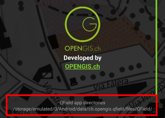

Manual configuration on portable device in QField
To transfer the shared datasets manually in QField, the datasets have to be added into the right directory on your device:
  • In QField, open a project.
  • Reveal the side legend by clicking on the icon with the three lines, and open the main menu by clicking on the 3-dotted button.
  • Select the 'About QField' menu tab.
  • The application directory locations will be displayed at the bottom of the screen just below the 'App directories' path (the paths differ depending on the operating system).
  • Copy your shared dataset files into the directory [App Directory]/QField/basemaps on your device. QField will automatically scan this folder for basemaps and other recognizable data.

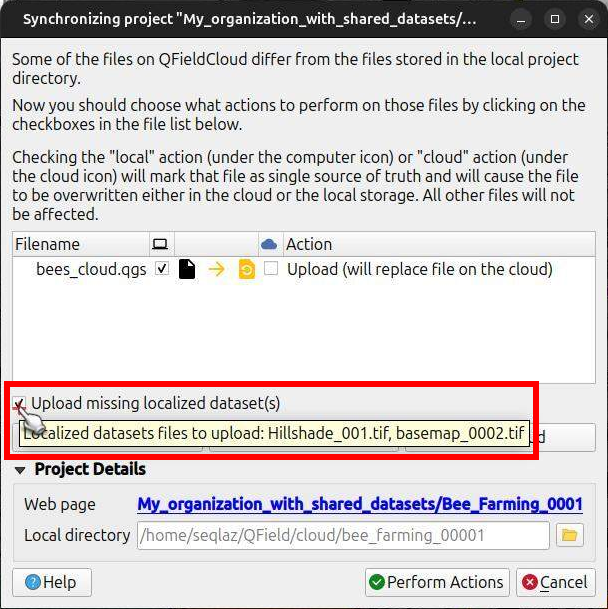

Synchronization with QFieldSync
  • In QGIS, open your project and use the QFieldSync plugin to upload to or synchronize with QFieldCloud.
  • At the beginning of the synchronization process, you will see a new Upload missing localized dataset(s) checkbox. Ensure this option is checked. If you hover over the checkbox, you will see the list of files that will be uploaded. This checkbox is only available for users with the permission to add files to the shared_datasets project.
QFieldSync Synchronization Dialog with Localized Datasets upload option enabled
  • Click on the Perform Actions button to proceed. During the upload phase, a list of the shared and regular project datasets will appear as they are being transferred. This instructs QFieldSync to find the actual data files referenced by your Localized Data Paths and upload them to the shared_datasets cloud project.

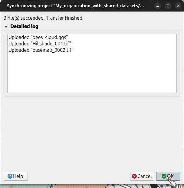

Review of the Upload Log
After the synchronization is complete, you can check the QFieldSync log. It will detail the files uploaded, including the shared datasets that were sent to QFieldCloud.

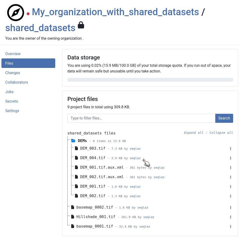

Localization of datasets within the QFieldCloud web interface
Once uploaded, these shared datasets will appear in two key places on the QFieldCloud web interface:
  • Within the dedicated shared_datasets project itself.
  • Referenced in the Files tab of any regular cloud project that utilizes them.

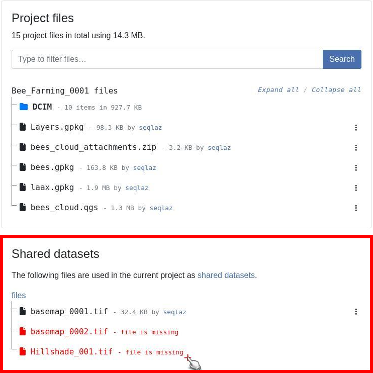

Shared datasets in cloud projects
  • Open your project in the QFieldCloud web interface.
  • Go to the Files tab.
  • You will find a section named Shared datasets. This dialogue lists all datasets that have been identified and uploaded as shared/localized resources for your projects.
List of Shared datasets files referenced in a regular QFieldCloud project
Checking the dataset status
For any cloud project containing shared datasets, QFieldCloud’s web interface will indicate those missing on the cloud (i.e., referenced by any project but have not yet been uploaded into the shared_datasets project) using a red color.
This can be fixed by synchronizing the project again from QGIS with QFieldSync, ensuring the "Upload missing localized dataset(s)" option is checked Synchronization with QFieldSync). Alternatively, if you have the necessary permissions, you can manage the shared_datasets project directly (see section Synchronizing directly the shared_datasets project).

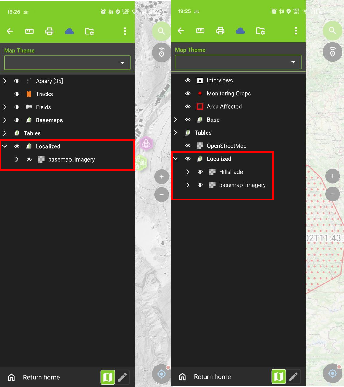

Shared datasets in QField
Users can simply download the projects to QField or synchronize pre-existing ones to access the shared datasets. A key benefit is that the download of these shared localized datasets is managed efficiently by QField. Each shared dataset will only be downloaded once, even if multiple projects use it. This saves storage space and synchronization time.
QField interface showing a project with shared localized datasets from QFieldCloud

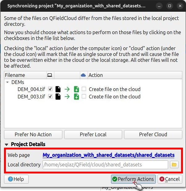

With QFieldSync
Users with 'manager' or 'admin' permissions for the shared_datasets project can manage its content directly using QFieldSync:
  1. In QFieldSync, download the shared_datasets project from QFieldCloud to a local directory on your computer.
  2. You can now add, update, or remove files within the preconfigured file directory of the localized datasets.
  3. Use QFieldSync (with the shared_datasets project selected) to synchronize these changes directly back to the cloud.

Localized files listed in the 'shared_datasets' cloud project on the web interface
