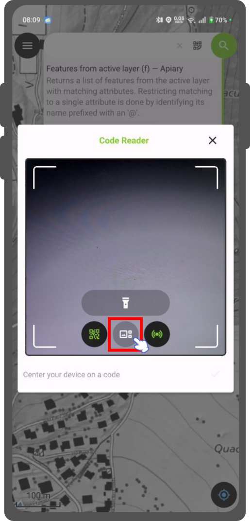

  1. Tap Scan code inside the search bar to open the Code Reader interface.
  2. Scan or decode a code using one of two methods:
    • Live Camera / NFC: Point the camera at a physical QR code or barcode, or hold an NFC text tag near the mobile device.
    • Image File from Gallery: Tap the Gallery icon on the bottom control bar and select a photo containing a QR code or barcode.
  3. Tap the checkmark (✔) button after decoding a code to execute the search query.
Search with Code Scanner
Use the QField Code Reader to search for features by scanning physical codes or selecting stored images.
Workflow
