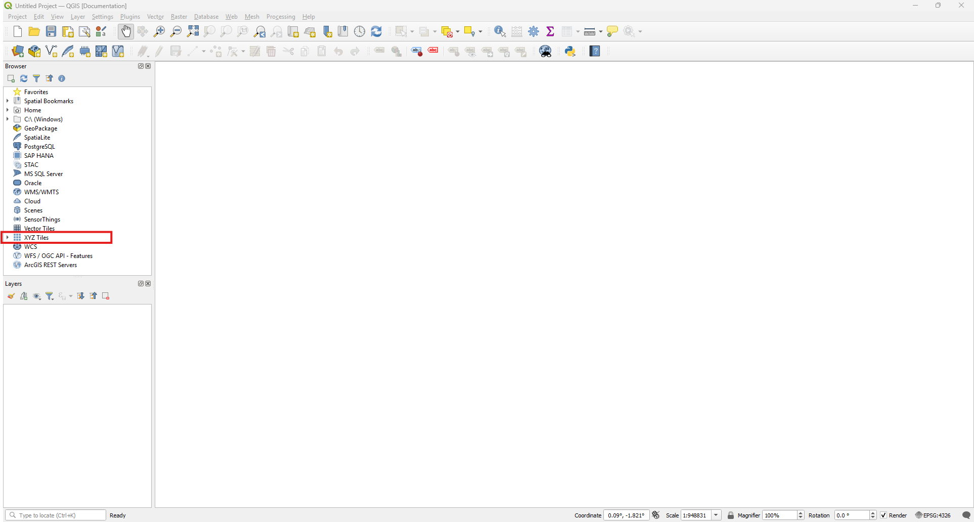

  1. Open a new QGIS Project on your desktop.
  2. Add a basemap of your choice to the project.
    • Under the browser on the top left of the QGIS window you will find the dropdown XYZ Tiles.
    • From there you can add the OpenStreetMap basemap, which is the most commonly used basemap.
    Adding a basemap
    Adding a basemap

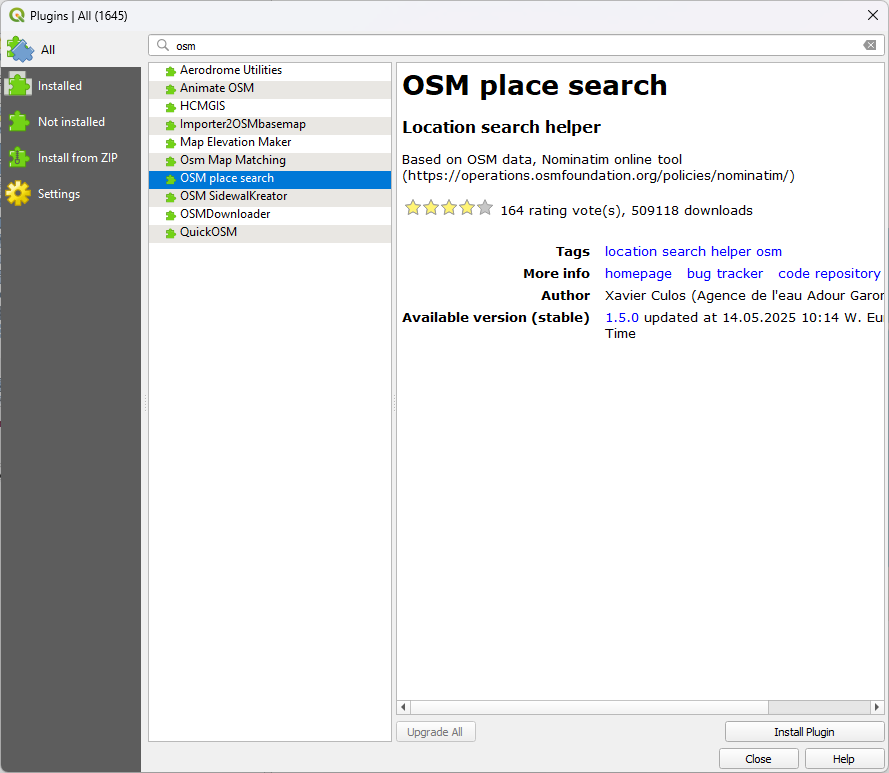

  3. We will now locate our area of interest. There exists a very useful QGIS plugin called OSM Place Search, which allows you to browse through the different place features available in the OpenStreetMap data.
    1. Under Plugins in the Menu toolbar direct to Manage and Install Plugins
    2. In the search bar type OSM Place Search and install the plugin
      OSM Place Search Plugin

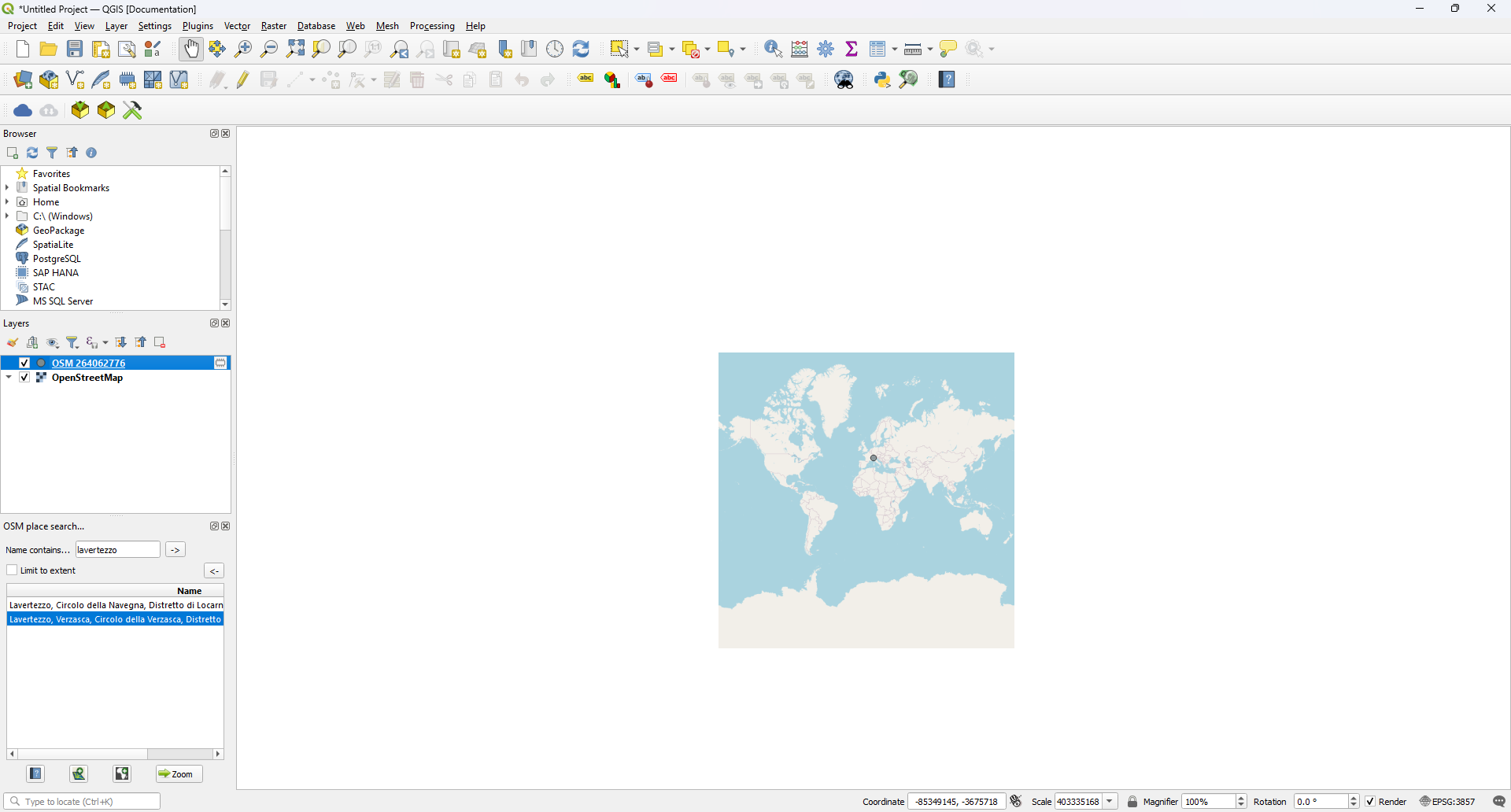

    3. A new window should appear in the side panel where you can enter your place of interest
    4. Add it to your project as a feature by clicking on the middle button at the bottom of the plugin interface.
      New PoI
      New PoI
    5. A new feature layer will be available as a temporary layer in your project.

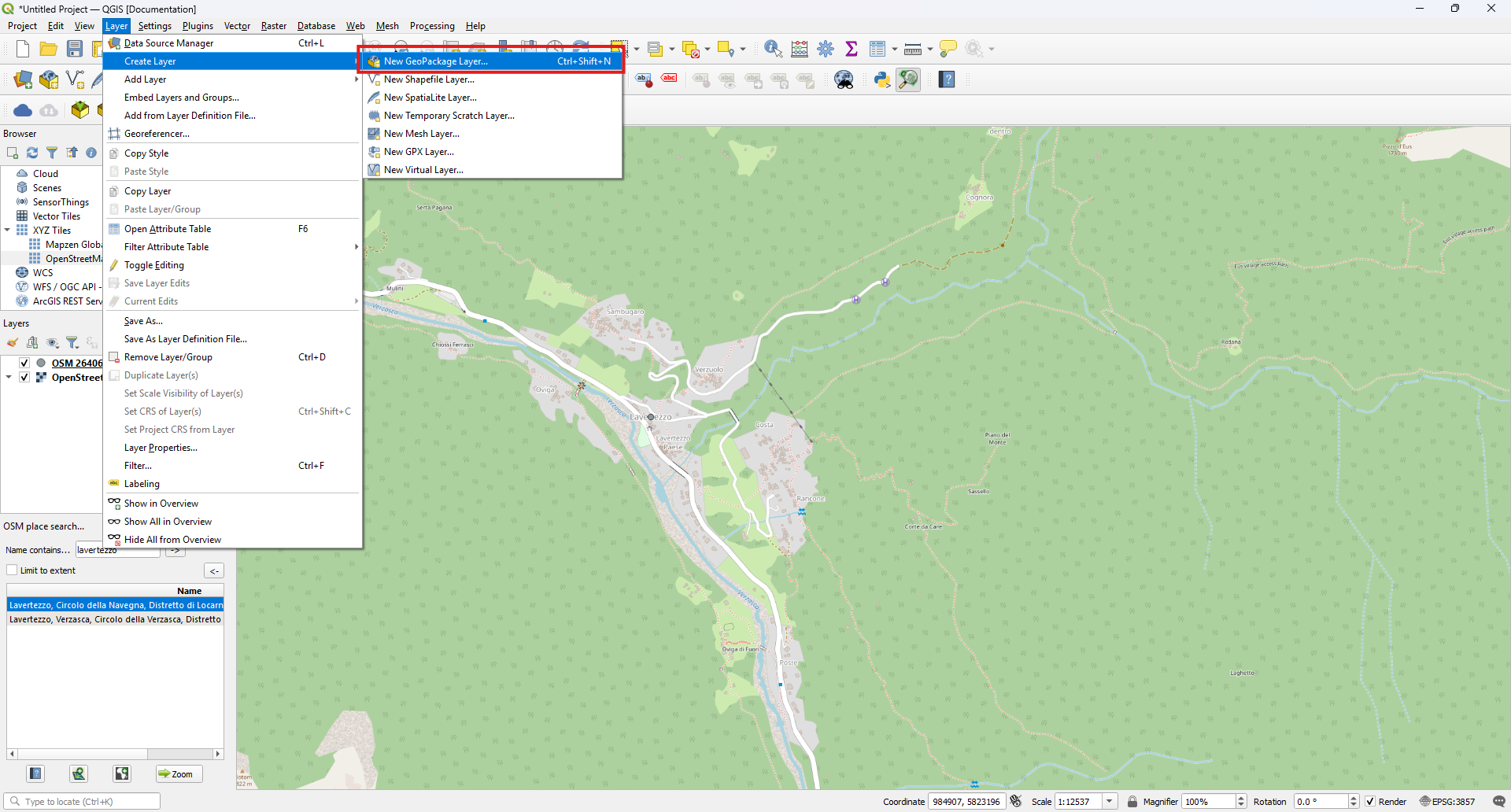

    6. Adding a new layer:
    7. Click on Layer and create a new Vector Layer
      New Vector layer
      New Vector layer
    8. Give your GeoPackage a general name. Additionally give a name to the table (which we are about to create). To Note: A GeoPackage can consist of several layers, including points, lines, polygons and raster layers.
    9. Select Point as your geometry type and select the EPSG:3857 WGS84/Pseudo-Mercator as your coordinate system. We will add a few fields to our layer including a name, a date, a field for a photo, a field for categorizing the point and a boolean field, which we will use to indicate whether it is worth to revisit the point or not. Finally, we will add another field where you can add general notes.

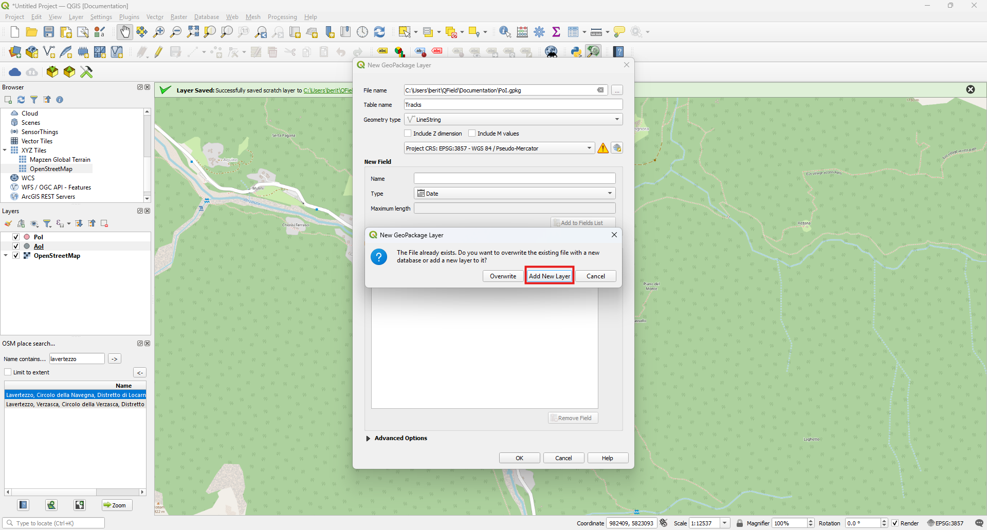

  4. Adding a Line layer
    We will create another layer within the GeoPackage corresponding to a line layer. You can use it to track yourself when going into the field.
    1. Add a new layer as previously
    2. Select the same GeoPackage as file name but give the table a different name.
      Line Layer
      Line Layer
    3. Add the following fields:
      Attribute Data type
      Name string
      Date date
  5. Saving the temporary layer in GeoPackage
    Remember that we have added our area of interest as a temporary layer meaning that after closing the project we will not be able to access the layer anymore. Therefore, we will save the layer within the just newly created GeoPackage.

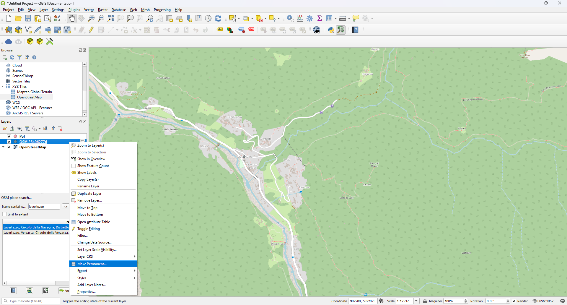

    Make permanent
    Make permanent
    1. Right-click on the layer and select Make Permanent
    2. Find the GeoPackage file that you just created and add an appropriate name to the PoI layer. Watch out: QGIS will ask you whether you wish to add new or to overwrite the layer. Of course, you choose to add new the layer.

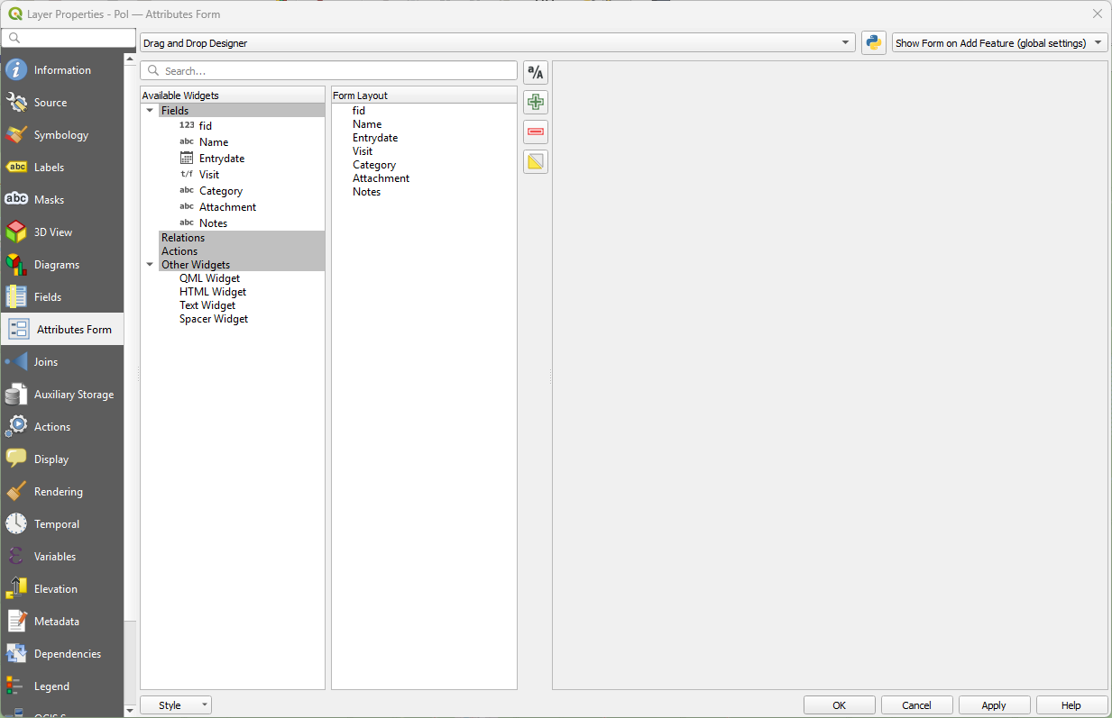

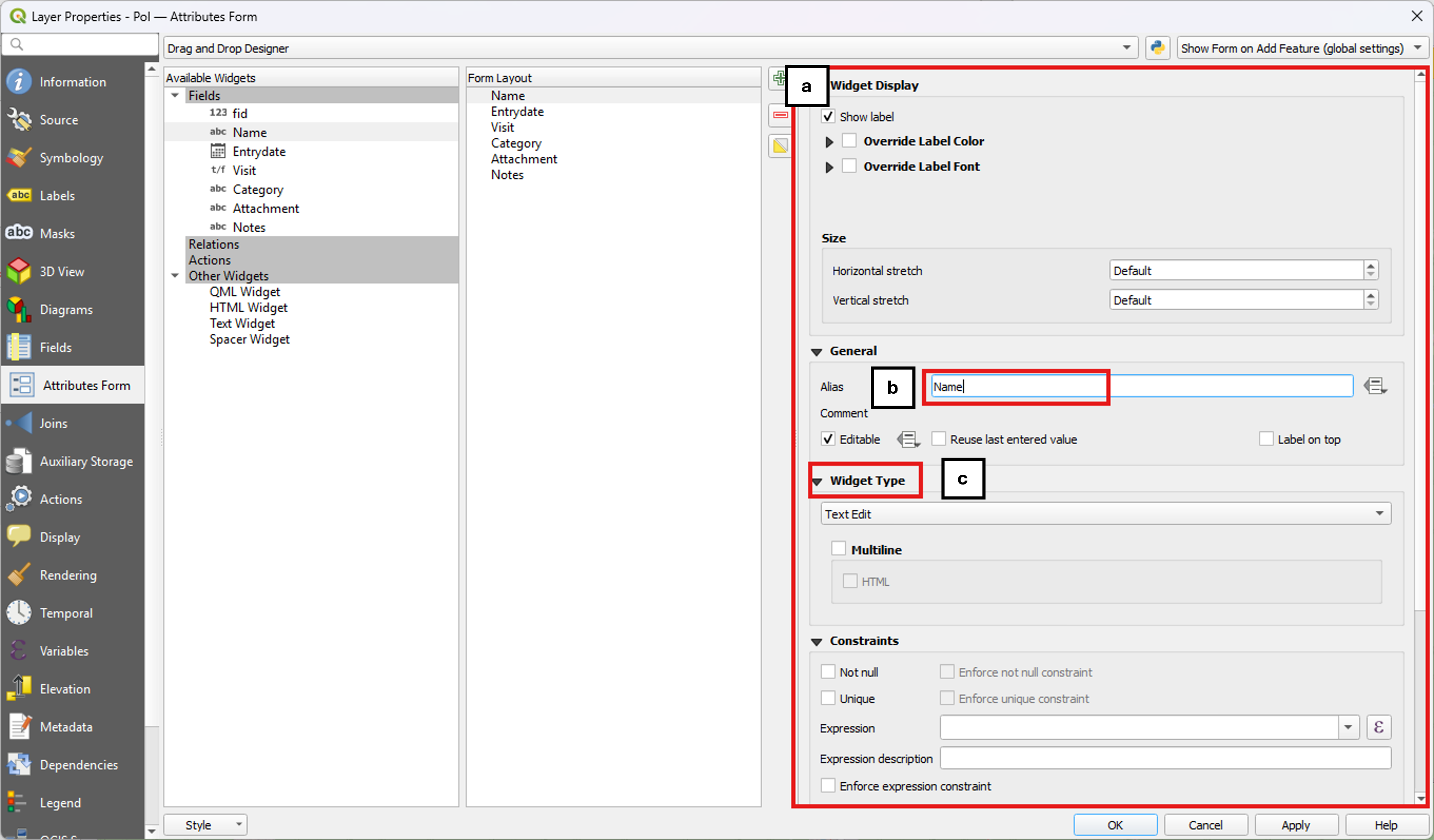

Now we have all the essential data in the QGIS project that we need for the data collection. However, in order to have a well structured form we need to configure the attribute form, via the file properties.
  1. Direct to PoIs layer Properties > Attribute Form
    Vector properties
    Vector properties
  2. Select Drag and Drop Designer from the dropdown. From here you can control the appearance of your form.
    Default Attribute Form
    We do not need to edit the fid field. QGIS creates this for every GeoPackage by default.
  3. Remove the fid field from the visible fields by pressing the red minus on the window
  4. Name: Click on Name and look at the Widget Display options on the right-hand side.
    Widget Display
    Widget Display
    The widget display let`s you customise the appearance of your form. You can keep it simple or set complex rules and constraints depending on your use case. Today, we will keep it simple.
    1. Here you can decide whether you want to display the name of your field inside the attribute form.
    2. If you have a technical fieldname with underscores or other special characters you can add an Alias to make it nicer for the data user.
    3. There exist several types of widgets Maya does not want to enter the date new every time. What a good thing one can set default values in QGIS

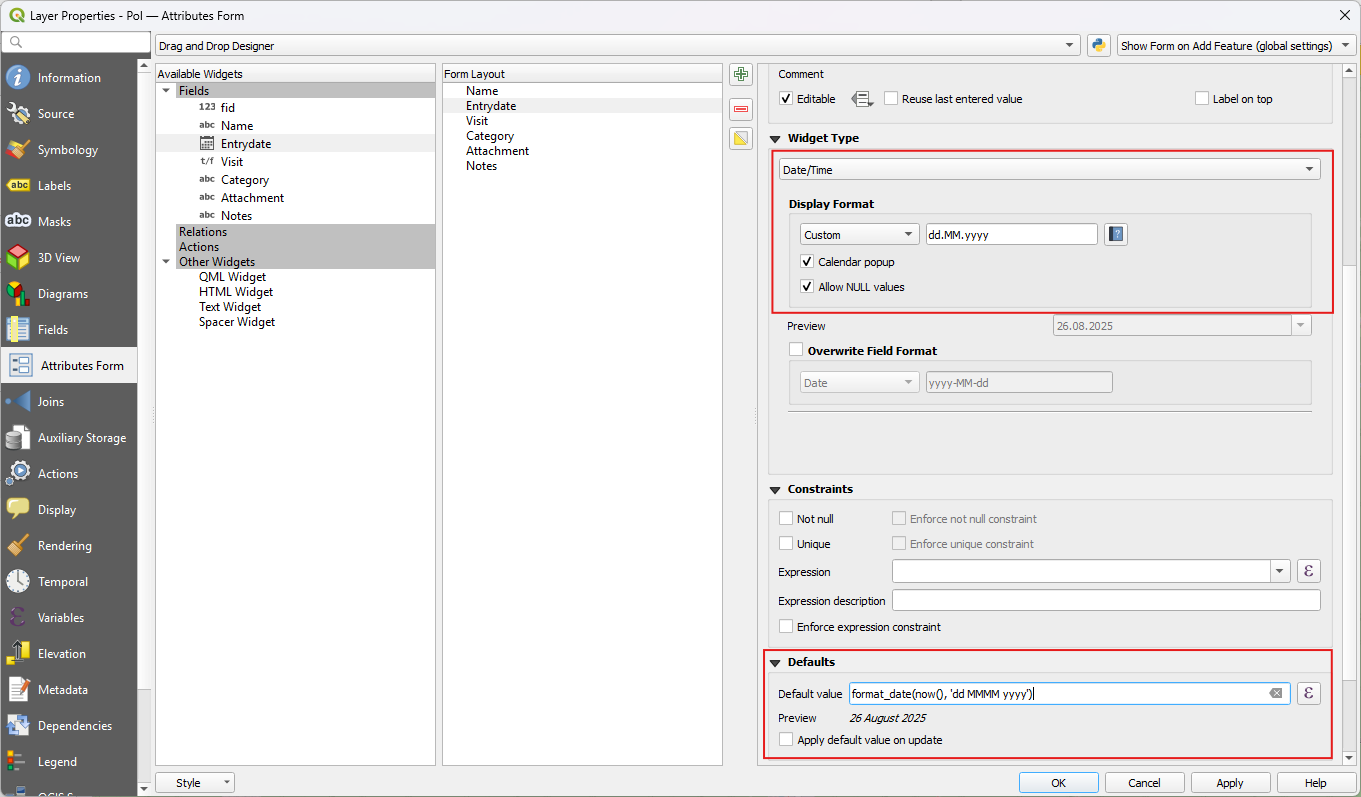

  5. Open the widget display of the Entrydate attribute.
    1. If not already done, change the widget type to date/time. You can customise the appearance of your date by changing the custom display format.
    2. To not have to add a new date every time, add a default value using the following expression format_date(now(),'dd MMMM yyyy'). This will populate the field with the time when the data point is created.
      Date widget
      Date widget

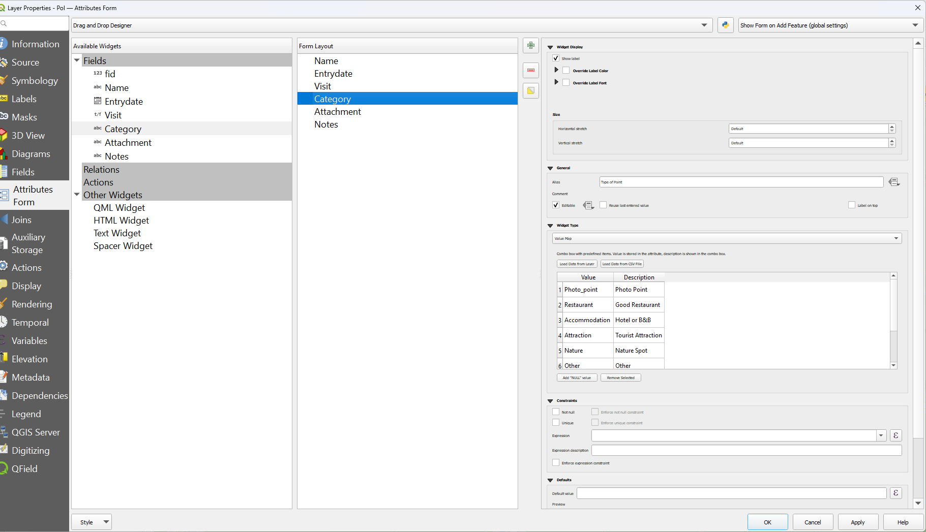

    The Category field is a bit more interesting. Maya wants to have a dropdown list from which she can select what type of location it is. Luckily, there is a widget type called value map, where we can enter some categories.
  7. Open the widget display for the Category field and change the widget type to Value map
  8. Enter some relevant categories to the value map
    Key Description
    Photo_point Photo point
    Restaurant Good Restaurant
    Accommodation Hotel
    Attraction Tourist Spot
    Nature Nature Spot
    Other Other
    Value map
    Value map

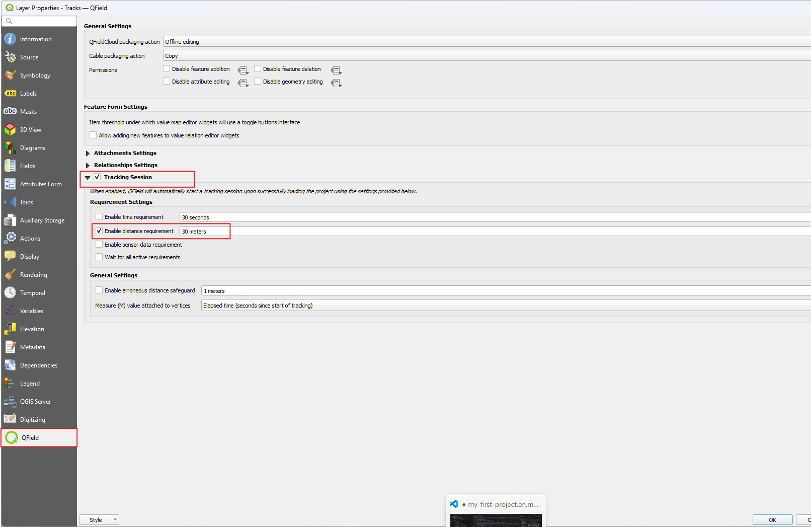

Form Configuration and Tracking Enabling of Tracks layer
Fantastic, we have successfully configured the form of the PoI layer. Maya wants to track herself immediately when starting to walk rather than having to set it up manually. Luckily this can be done by setting up the tracking session in the QGIS project file
  1. Direct to the Tracks Properties > QField
  2. Enable the Tracking session and set the required parameter. You can decide whether you want to add vertices based on a temporal value or based on distance. We will use the latter option for this purpose. You will configure the attribute form in such a way that it automatically populates the attribute fields when starting a new session. Furthermore, you will hide the attribute form so that the tracking just runs in the background.
