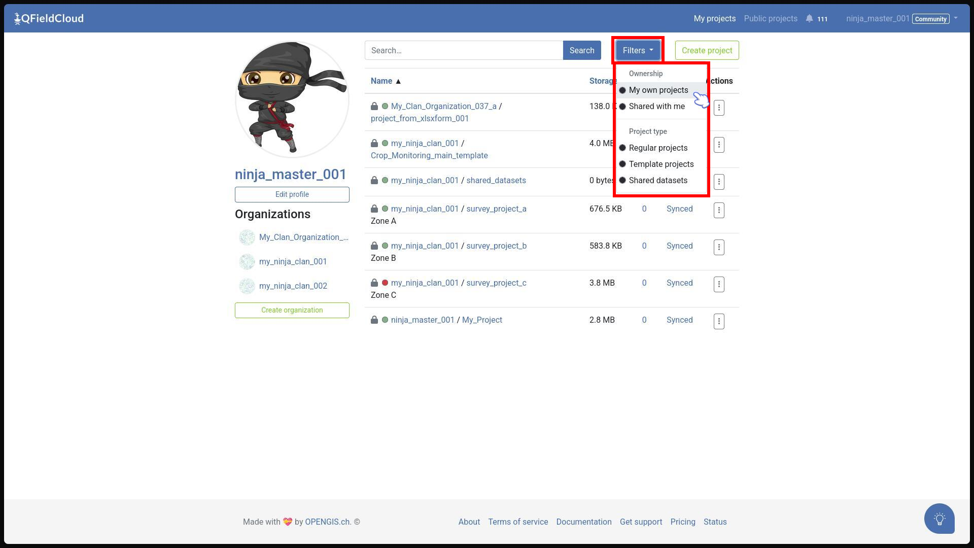

Filtering projects
When managing a large number of cloud projects, you can refine your project list using the Filters dropdown button located next to the search bar.
The dropdown menu allows you to filter projects by three primary criteria:
  • Ownership: (User accounts only):
    • My own projects: Displays only projects where your account is the primary owner.
    • Shared with me: Displays projects owned by collaborators or organizations where you have been granted access.
  • Project type:
    • Regular projects: Standard QGIS mapping projects created for field data collection.
    • Shared datasets: Centralized datasets stored in the dedicated shared_datasets project repository.
    • Template Projects: Projects locked for fieldworkers and used exclusively as project templates.
When any filter option is active, clicking the Clear button immediately resets all active filter parameters and restores the full project view.

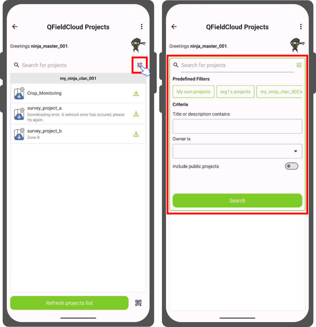

Advanced project searching and filtering
Fieldwork
To manage a large number of projects, QField features a search-and-filter panel directly on the QFieldCloud projects screen. The Filter button is located to the right of the project search bar.
1. Predefined filter presets
Quick preset buttons appear at the top of the filter panel (such as My Own Projects or {org_name}'s projects). Tapping a preset populates the criteria form and automatically filters the underlying list.
2. Form-based filtering criteria
Refine your project search using the form fields in the filter pane:
  • Search term: Selects every project title or description containing the provided term.
  • Owner: Displays a list of unique project owners available to your account in an editable dropdown menu.
  • Include public projects: Toggles community public projects on or off.
Public projects are projects marked as public by any project owner. Public projects are viewable by all QFieldCloud users. if the project owner adds them as project collaborators. You do not need an organization account to collaborate on public projects.
3. Power-User search syntax
The main search bar allows users to type advanced filter parameters directly using key-value syntax. Key parameters are dynamically recognized and highlighted inside the text input box.
Supported syntax tokens include:
  • owner:name — Filters the list to show projects belonging to a specific user or organization account name.
  • include:public — Forces public projects to be included in the query evaluation.
Example Query: Typing owner:My_Organization include:public Forestry into the search field isolates public projects matching the keyword "Forestry" owned by "My_Organization".

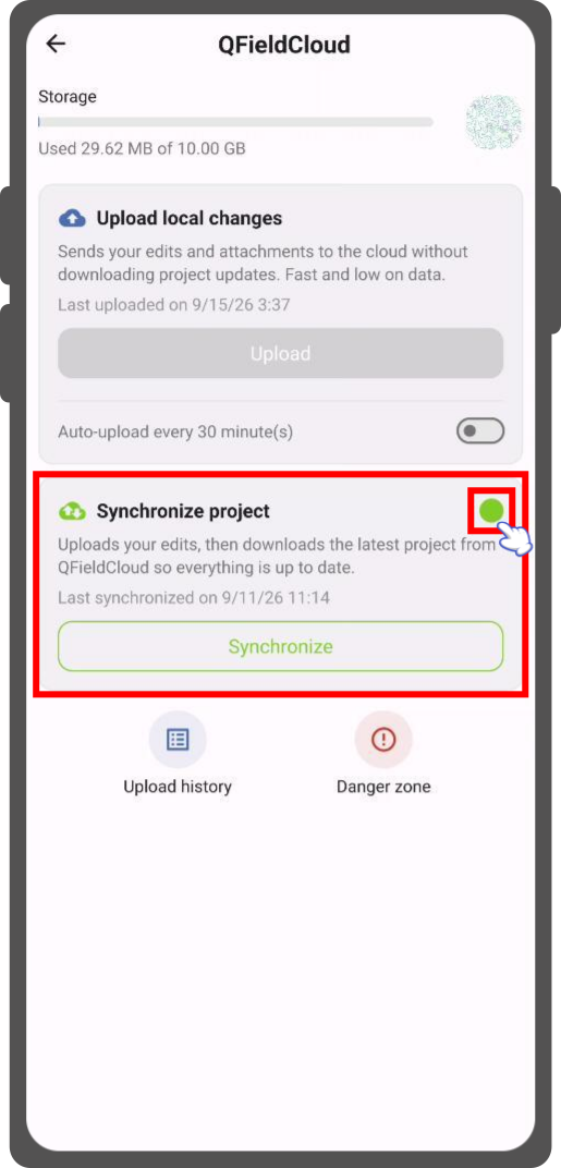

QField will indicate whether your project has changes locally that are not yet uploaded to QFieldCloud or a new version of your project is available on QFieldCloud.
  1. To get notified about the project update on the cloud, you need to be online and logged in.
  2. If a new version is available, you should synchronize your project as soon as possible.
There are two ways in which you can see whether your project is up-to-date with the version on QFieldCloud.
  • Cloud Icon Badge: A green bubble with an exclamation mark appears on the cloud button in the Side Dashboard.
  • Synchronize Project Card Badge: A green badge appears on the right side of the Synchronize project section within the cloud synchronization.
