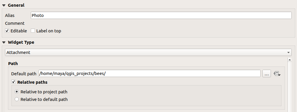

Configure Attachment Widget
Desktop preparation
The widget type Attachment is used with fields that store the path to files.

The path should be set to relative. The pictures, audios, videos, pdf and docs are stored then in a sub-directory of the project, where the link stored in the textfield is pointing to.
