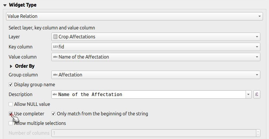

Configure a Value Relation Widget
Préparation Ordinateur
The widget Value Relation offers values from a related table in a combobox. You can select layer, key column and value column. Several options are available to change the standard behaviors: allow null value, order by value and allow multiple selections. The widget will display a drop-down or multiple-select list of the referenced features.

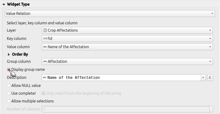

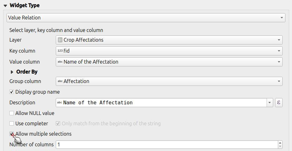

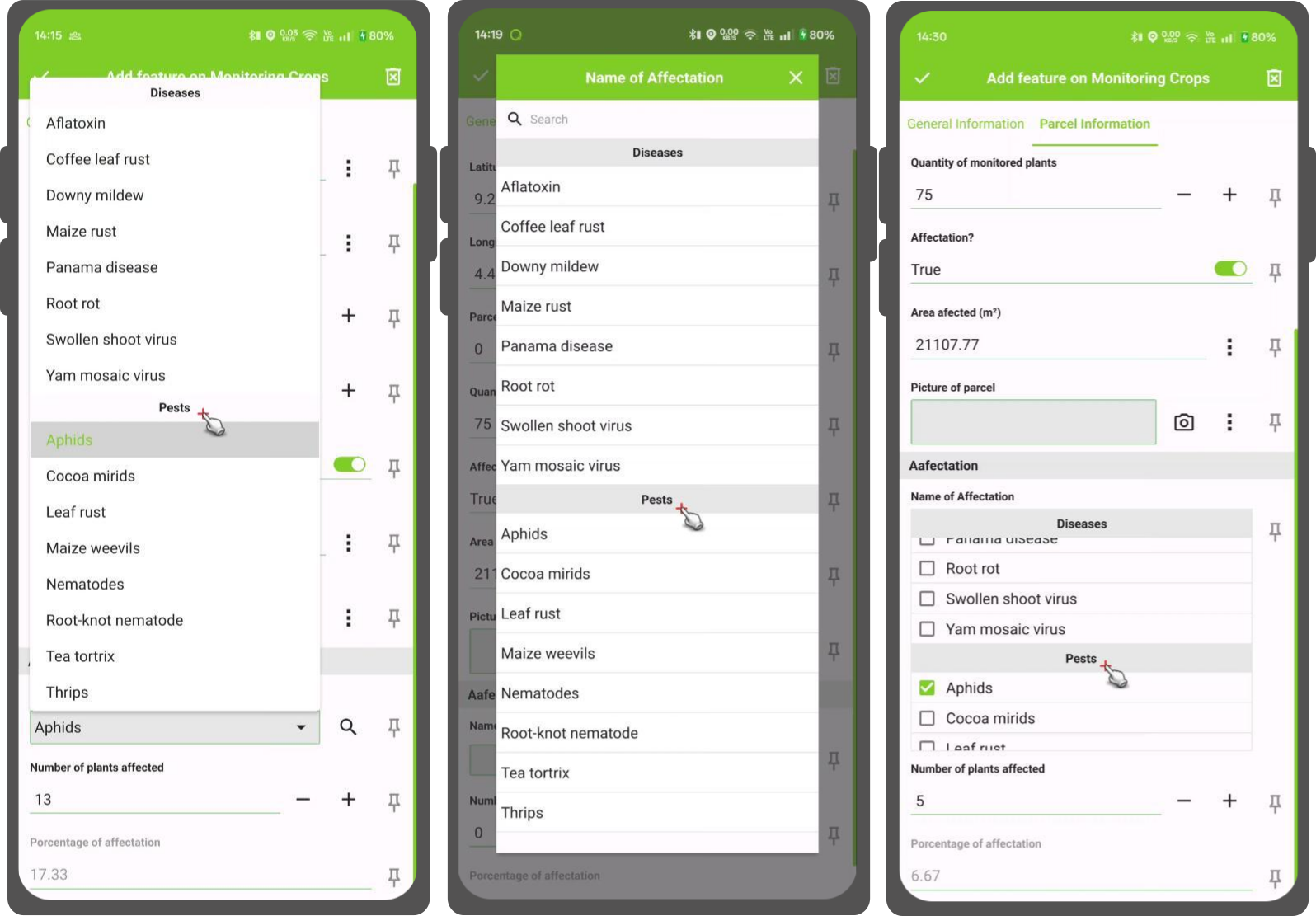

Group Values in the Value Relation Widget
You can organize and optimize the appearance of your Value Relation widgets by grouping related items together. This feature allows you to categorize the values in a dropdown list or in a table view based on the content of a chosen column.
For example, if you have a list of cities, you can group them by their respective states. This makes it easier for users to navigate and find the values they need, especially in lists with a large number of items.
Configuration
Grouping is configured within the Value Relation widget's settings using the following options:
  • Group column: Choose the column from the layer that will be used to organize the items. The values from this column will act as group title.
  • Display group name: Check this box to display the group title as distinct header within the widget. This creates a clear separation between the different groups, making the list easier to navigate.

Different configurations on QField

Configure Auto-complete Value
The "Use completer" checkbox must be checked to be able to use the auto-complete in the value relation.
Enable auto-complete within QGIS
Here is a video showing how it works on QField
