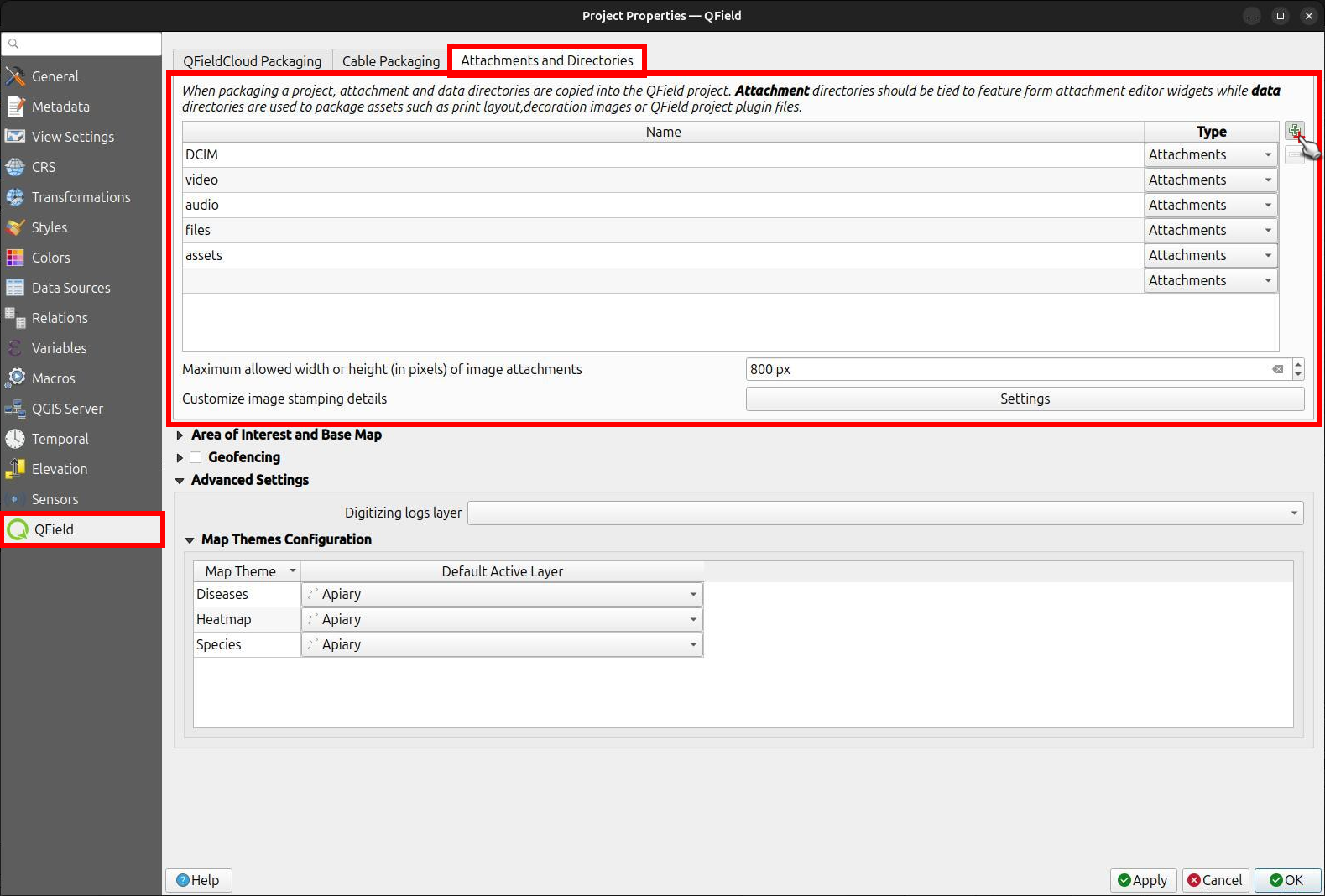

Configuration of Attachment Folders
If your project contains photos, documents or other attachments, you have to configure your QGIS project accordingly to ensure that the data are downloaded to your QField device.
  1. In QGIS navigate to Project > Properties... > QField.
  2. Add your folder's path to the "Attachments and Directories" list. The path you enter must be relative to the location of your project file.
Example
You used pictures for a specific symbology. These are stored in a folder named "assets" located inside your project home folder. Add them under the folder name to the list.
