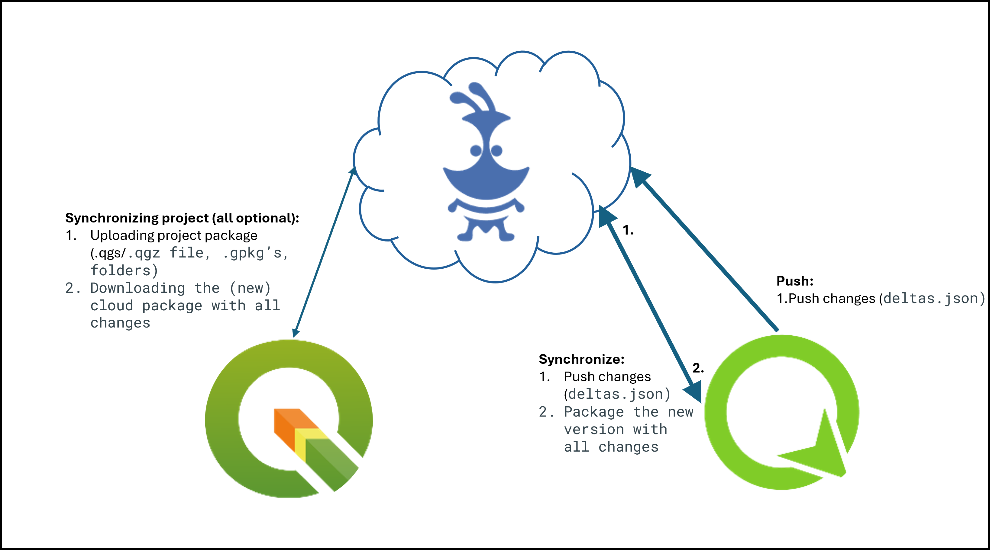

Synchronization Process
When working with QFieldCloud, it is important to understand the synchronization process to avoid data loss or overwriting files and deltas. You can find technical details on the different job types in the technical documentation section. In simple words, three different synchronization activities exist:
  • From QGIS to QFieldCloud: Uploads a complete new project package and replaces the existing package stored in the cloud. When working with GeoPackages, the existing GeoPackage in the cloud is replaced with the newly uploaded file.
  • From QFieldCloud to QField: Downloads the uploaded project package to your mobile device. QFieldCloud packages the project into a specific format saved in the internal application folder structure. When working with PostgreSQL databases in offline editing mode, a local GeoPackage is created in the corresponding folder (ensure your secret is configured properly).
  • From QField to QFieldCloud: Applies changes as deltas after completing data collection. Deltas reflect only the attribute and geometry changes made in the field. When uploading or synchronizing with QFieldCloud, only the deltas are applied, so the entire GeoPackage is not replaced.
Simple Synchronization Overview
Tip
We recommend following these guidelines to avoid synchronization issues or overwritten data:
  1. Do not modify the QGIS project while personnel work simultaneously in QField. If you synchronize your desktop version to the cloud, QFieldCloud will overwrite the files. If you must work in parallel on your desktop, check the QFieldCloud status and download the most recent data before uploading new file versions from desktop.
  2. Do not change the data structure before synchronizing the latest field edits. Adapting the data structure in QGIS before pushing field edits leads to errors if changes from QField have not yet been uploaded.
  3. Use UUIDs as primary keys, especially when working with relations and in teams. Synchronization issues often occur due to missing primary keys in datasets. Without explicit primary keys, simultaneous editing can cause data loss.
