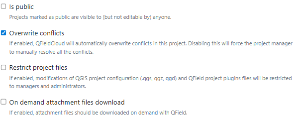

Restriction of Project Files
To prevent collaborators from altering project configurations, project administrators can enable file restrictions on QFieldCloud.
Workflow
  1. Open your project in QFieldCloud and navigate to Settings.
  2. Enable Restrict project files.
Once enabled, only users with Admin or Manager roles can upload or modify restricted files, while Editors can continue pushing dataset changes.

Handling Conflicts
When multiple field users synchronize edits to the same project, conflicts can occur if users modify the same feature or enter duplicate values in unique-constrained fields.
On your project's Settings page in QFieldCloud, you can configure two conflict-handling behaviors:
  • Overwrite conflicts: Choose whether QFieldCloud automatically resolves concurrent feature edits using the Last Wins policy or flags conflicts for manual review by project managers.
  • Unique constraint delta behavior: Choose how QFieldCloud handles deltas when a field configured with a Unique constraint in QGIS receives a value that already exists in another feature:
    • Create a conflict (Default): Flags the delta as a CONFLICT for manual resolution, even if Overwrite conflicts (Last Wins) is enabled.
    • Let the QGIS default behavior apply: Allows QGIS to automatically adjust duplicate values on newly created features (such as appending _1 or incrementing numbers) while letting the underlying data provider validate updates.
Read more on conflict detection and resolution in the Jobs Technical Documentation.
