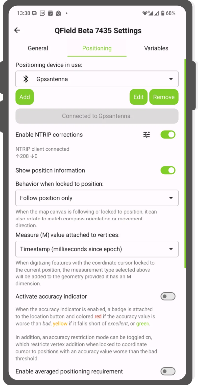

QField is capable to show the live position using several sources:
  • Either by using the internal GNSS (Global Navigation Satellite System, like GPS, GLONASS, Galileo or Beidou) of the mobile device (typically 5 m accuracy) or
  • Through an external antenna through NMEA streams over Bluetooth, TCP, or UDP connection. (typically 1.5 m accuracy) or

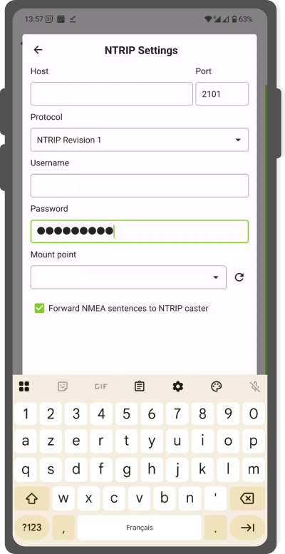

  • Through an external antenna connected to an additional NTRIP service (down to cm accuracy)
Tip
Use an external GNSS antenna for high-accuracy surveying, as internal mobile GNSS hardware is limited to roughly 5 meters of accuracy. External receivers also provide accurate elevation measurements alongside 2D coordinates.
QField requires external GNSS devices to output positioning data in the EPSG:4326 (WGS 84) coordinate reference system. Customized device output CRSes are not supported and will cause coordinate shifts.
Using an external GNSS Receiver
QField supports connecting to external GNSS positioning devices via NMEA streams through Bluetooth, TCP, or UDP connections.
