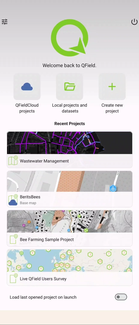

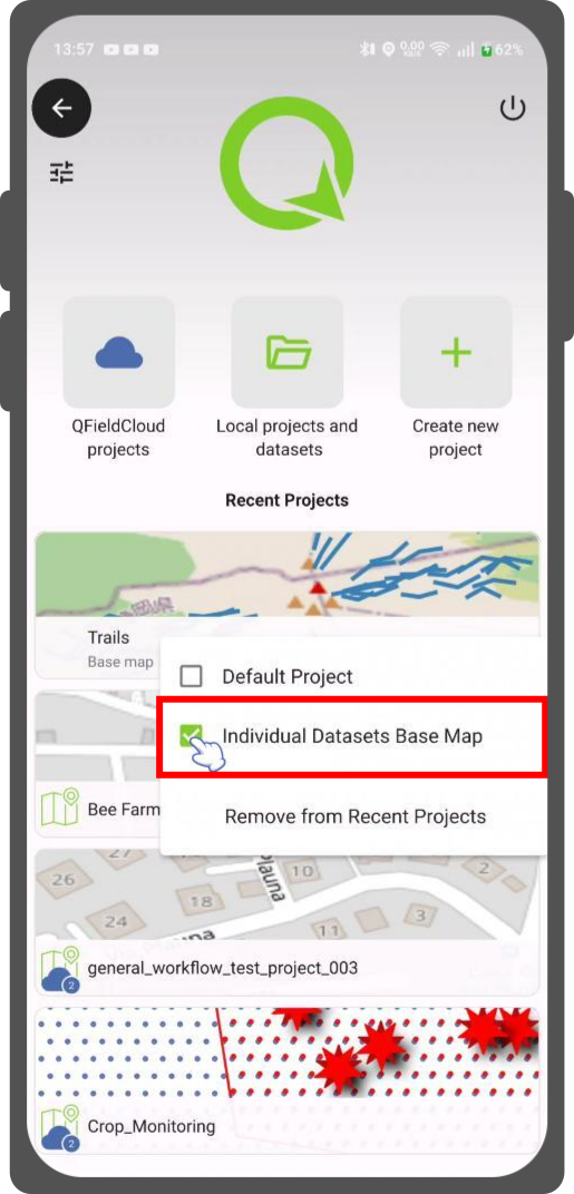

Using a Project as a Base Map for Standalone Datasets
Fieldwork
Standalone datasets display over a default OpenStreetMap XYZ tile layer. Set any QGIS project stored on your mobile device as a custom background base map.
Workflow
  1. Open QField and navigate to the project selection screen.
  2. Long-press the QGIS project file you want to use as a base map.
  3. Select Use as Base Map in the context menu.
