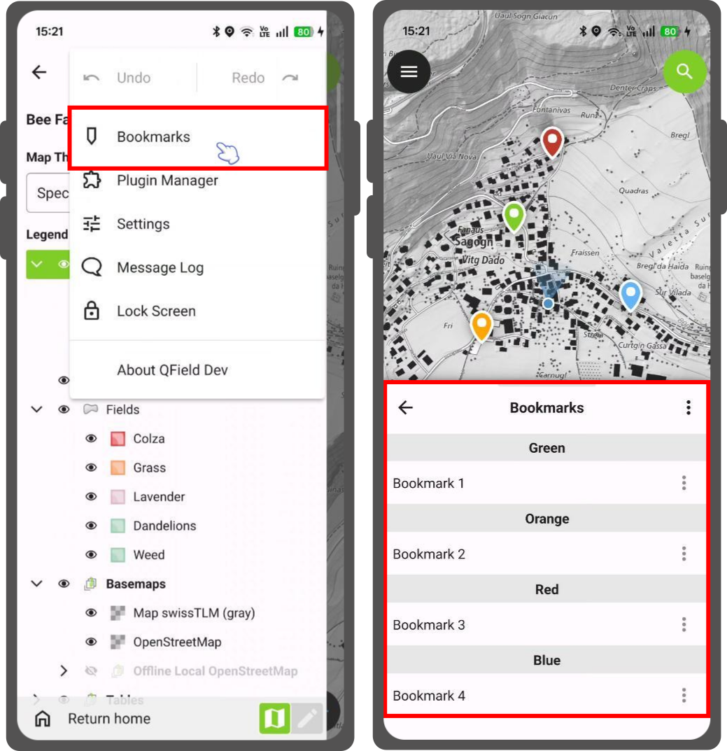

Bookmark List Panel
Fieldwork
QField includes a dedicated side drawer to manage and browse bookmarks.
Workflow
  1. Open the Side Dashboard from the map canvas.
  2. Tap the three-dotted menu (⋮) and select Bookmarks.
  3. Browse bookmarks categorized by color groups (Green, Orange, Red, Blue) or under the Project bookmarks header.
  4. Tap any bookmark entry in the list to pan and zoom directly to its location on the map canvas.

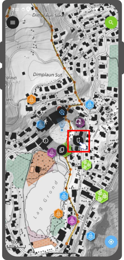

Option 2: Location Pie Menu
Workflow
  1. Tap your current location marker on the map canvas.
  2. Tap the bookmark icon in the bottom-right corner of the pie menu.
  3. Enter a bookmark name and select a color group.

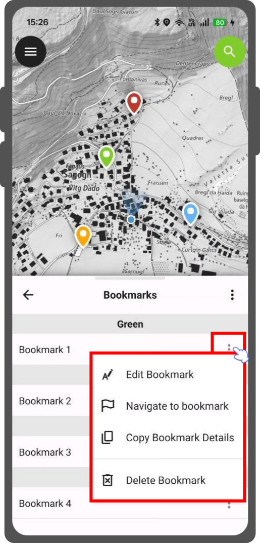

Individual Bookmark Actions
Open the Bookmark List panel and tap the three-dotted menu (⋮) next to a user bookmark to perform the following actions:
  • Edit Bookmark": Modifies the bookmark name or color group.
  • Copy Bookmark Details": Copies the bookmark name and geographic coordinates to the device clipboard.
  • Navigate to bookmark": Sets the bookmark as the active navigation destination.
  • Delete Bookmark": Deletes the bookmark.

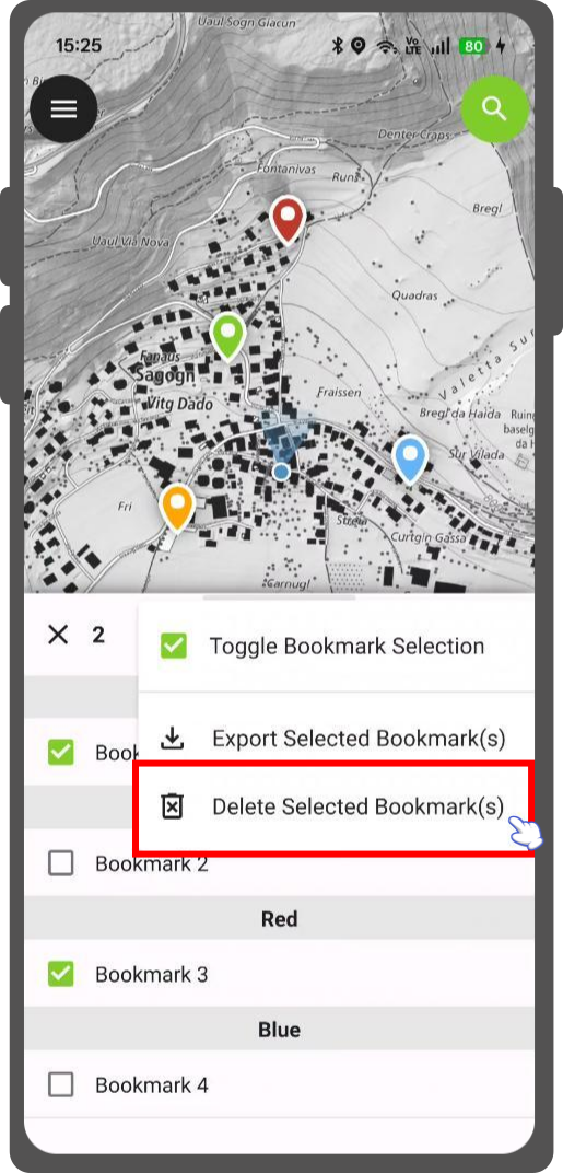

Multi-Selection and Batch Deletion
Workflow
  1. Open the Bookmarks list panel from the Side Dashboard.
  2. Long-press a user bookmark or tap the top three-dotted menu (⋮) and select Toggle Bookmark Selection.
  3. Check the selection boxes next to target bookmarks.
  4. Tap the three-dotted menu (⋮) and select Delete Selected Bookmark(s).

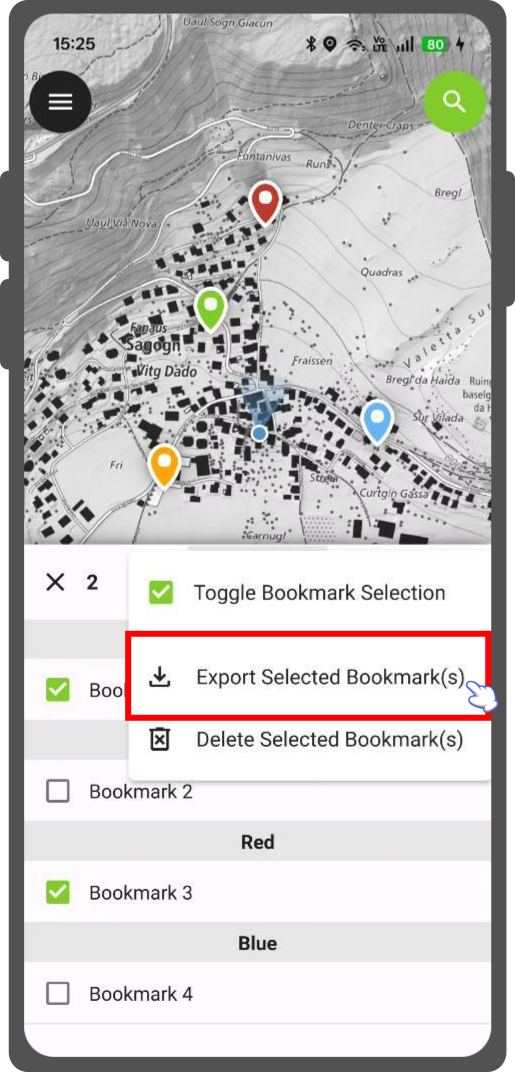

Exporting Bookmarks to GeoPackage
Export user bookmarks to a standalone GeoPackage (.gpkg) file to archive or share with colleagues.
Workflow
  2. Select target bookmarks or export all bookmarks:
    • Export all user bookmarks: Tap the top three-dotted menu (⋮) and select Export All User Bookmarks.
    • Export selected user bookmarks: Select target bookmarks, tap the top three-dotted menu (⋮), and select Export Selected Bookmark(s).
  3. QField compiles bookmark geometries, names, and color attributes into a .gpkg file and opens the native device sharing dialog (Send to...) to transfer the file via email or cloud storage.

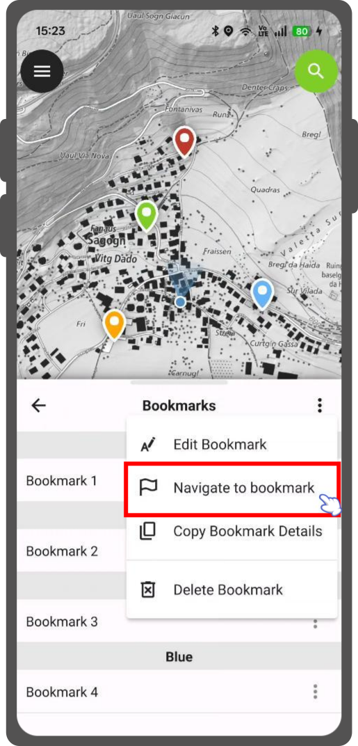

Set any spatial bookmark as an active navigation destination.
Option 1: Via the Bookmark List Panel
Workflow
  2. Tap the three-dotted menu (⋮) next to the target bookmark.
  3. Select Navigate to bookmark (navigation flag icon).
  4. QField sets the bookmark coordinates as the active navigation target.
