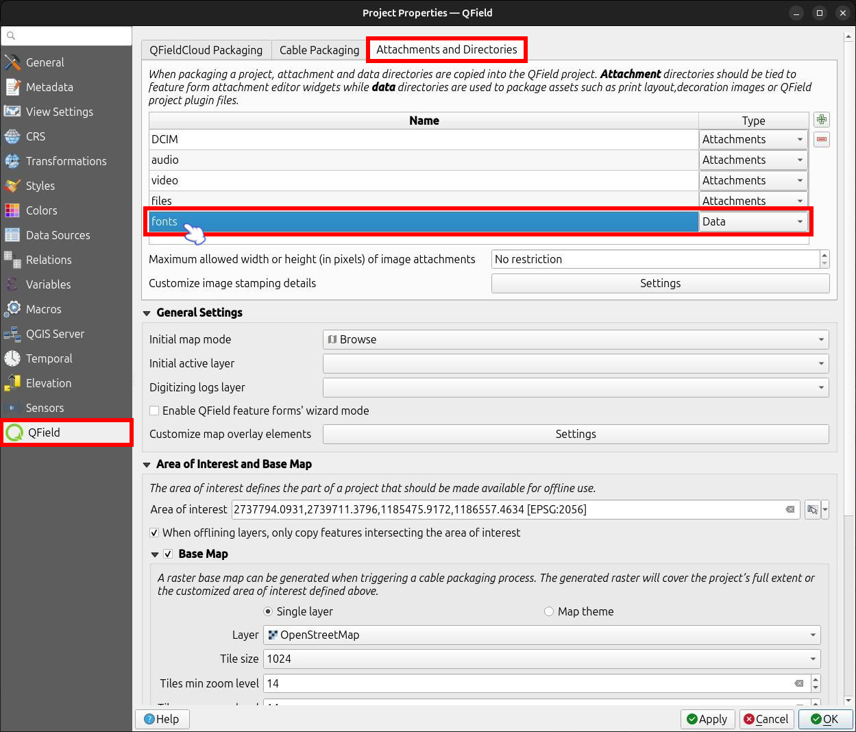

QField allows you to use custom fonts in your projects. You can register additional fonts using two methods:
  • System-Wide Fonts (App Directory): Copy your font files (.ttf or .otf) into the App Directory/QField/fonts. These fonts become accessible across all projects and individual datasets on the device.
  • Project-Specific Fonts: Create a subfolder named fonts inside the same directory as your QGIS project file (.qgs or .qgz). These fonts are accessible only when viewing that specific project.
When creating a QFieldCloud project that includes custom fonts in a fonts subfolder, add this directory to the synchronized directories list in your project settings. This ensures custom font files are pushed to QFieldCloud and downloaded to mobile devices.
Workflow
  1. In QGIS, navigate to Project > Properties... > QField.
  2. Under the Attachments and Directories tab, add the relative path of your fonts subfolder to the directories list as a Data directory type.
Configuring custom fonts folder for QFieldCloud synchronization.

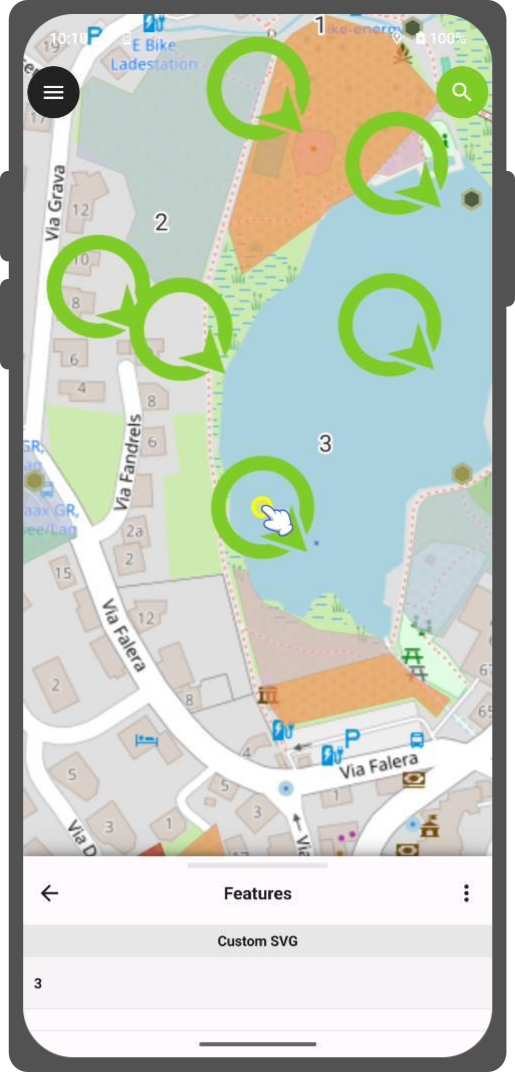

Custom SVG Symbols
Desktop preparation
You can embed SVG symbols directly within a QGIS project file.
Workflow
  1. Select the layer requiring custom SVG symbology and open its properties dialog.
  2. Navigate to Vector Layer Properties > Symbology.
  3. In the Symbol Layer Panel, select Simple marker.
  4. Change the symbol layer type to SVG marker.
  5. Scroll to the bottom panel and click the dropdown menu icon next to the file selection button.
  6. Select Embed File... and choose your SVG file in the file picker.
  7. Apply the changes and click OK.
Embedded custom SVG on QField
