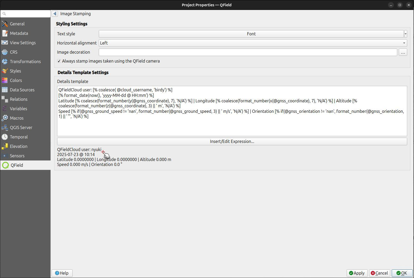

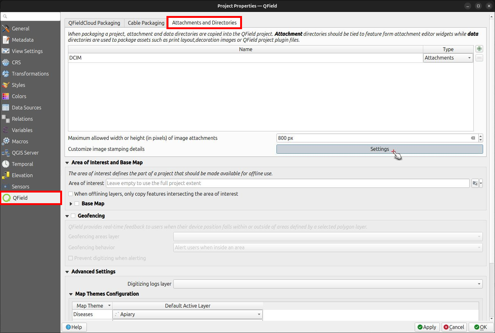

Maximale Bildgröße
The maximum height and width can be configured in QFieldSync plugin > Project configuration
The advanced settings allow to rescale the photos to a maximum width/height.

Speicherpfad für Bilder
It is also possible to synchronize additional directories with pictures or other attachments. Additional paths can be configured in Attachment directories. All paths are relative to the project directory.
Anhangverzeichnisse
Anhangverzeichnisse
