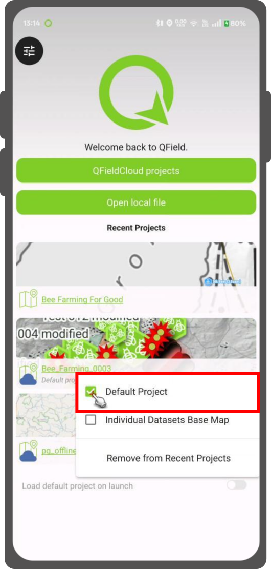

Set Default Project
This functionality allows you to set a specific project to be used as the default basemap whenever you open individual datasets. This is useful when a QFieldCloud project should be used as a basemap.
How to Set a Default Project
  1. In the welcome screen Recent Projects list.
  2. Press long on the project you wish to set as your default basemap.
  3. From the context menu that appears, select Set as Default Project.
Basemap Loading Logic
When you open an individual dataset, the application will now determine which basemap to load based on the following hierarchy:
  1. Default Project: The application will first check if a default project has been set. If so, it will be used as the basemap.
  2. Basemap File: If no default project is set, the application will look for a basemap.{qgs/.qgz) file within the QField directory on your device. If found, this project will be used.
  3. OpenStreetMap: If neither a default project nor a basemap file is found, a default OpenStreetMap XYZ layer will be loaded as the basemap.
