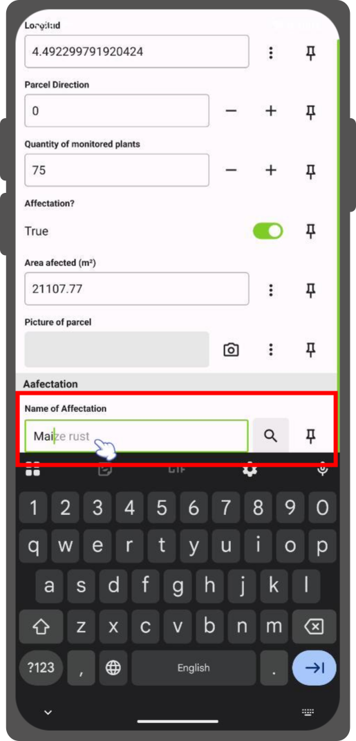

Use Auto Complete
Project Manager
Flujo
  1. Navigate to Vector Layer Properties... > Attribute Form.
  2. Set the widget type to Value Relation.
  3. Enable Use completer.
Enable auto-complete within QGIS
Trabajo de campo
Auto-complete in QField
