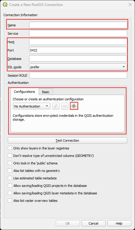

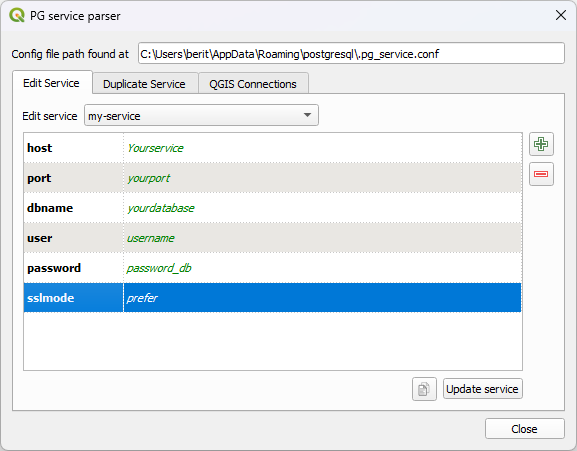

A pg_service.conf file allows to use an named alias for a PostgreSQL server connection. Instead of storing hostname, port, database name and more into the QGIS Project file, these can be stored separately. It is even possible to store username and password in a pg_service.conf file, to avoid having this stored in clear text in the QGIS Project.
