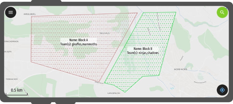

QFieldCloud Variables
For QFieldCloud users, three expression variables can be used in forms or default values:
  • @cloud_username - Returns the name of the currently logged-in QFieldCloud user.
  • @cloud_useremail - Returns the email address of the currently logged-in QFieldCloud user.
  • @cloud_team - Returns the name of the Team to which the user belongs within the organization.
