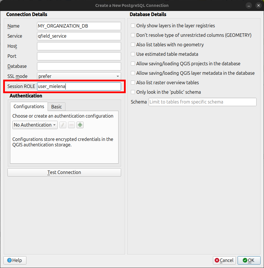

2. QGIS Configuration (The Generic Connection)
In your QGIS Project, configure your PostgreSQL/PostGIS connection to authenticate as the generic qfield_admin.
You do not need to hardcode the "Session role" in the QGIS connection settings for this workflow. Leave it blank, as QFieldCloud is responsible for injecting the role dynamically through the secret. Although QGIS allows setting a "Session role" manually, for QFieldCloud workflows, it is often better to manage this via Secrets to keep the QGIS project file generic, unless the field worker needs to perform reviews directly in QGIS.
Setting session ROLE in QGIS
