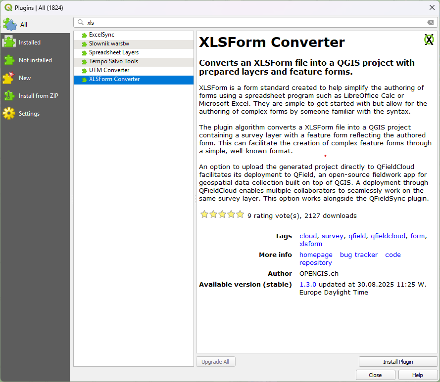

  1. Direct to Plugins > Manage and Install Plugins > All
  2. Search for XLSForm Converter and click "Install Plugin".
    XLSForm Converter Plugin
