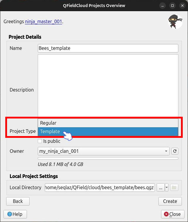

When creating a project in QFieldSync, change the project type to Template if you want it to be used as a template.

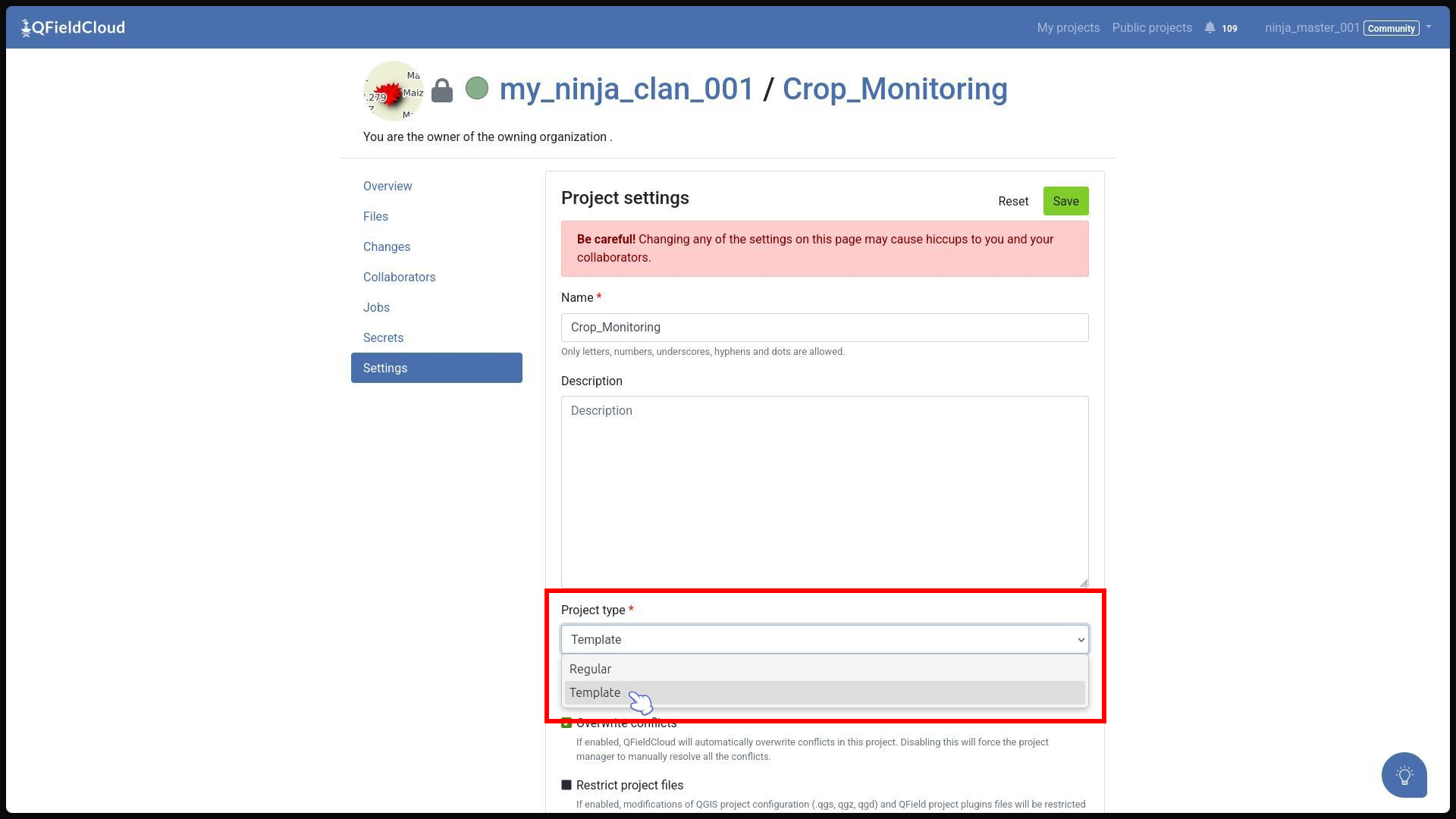

To designate a project as a template (when already exist in QFieldCloud), navigate to the project's Settings section and change the Project Type dropdown to Template.
