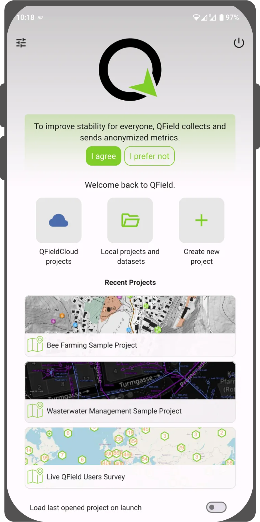

- Open QField on your mobile device.
- Tap the plus button (+) on the Welcome Screen.
Welcome Screen - Select your preferred basemap:

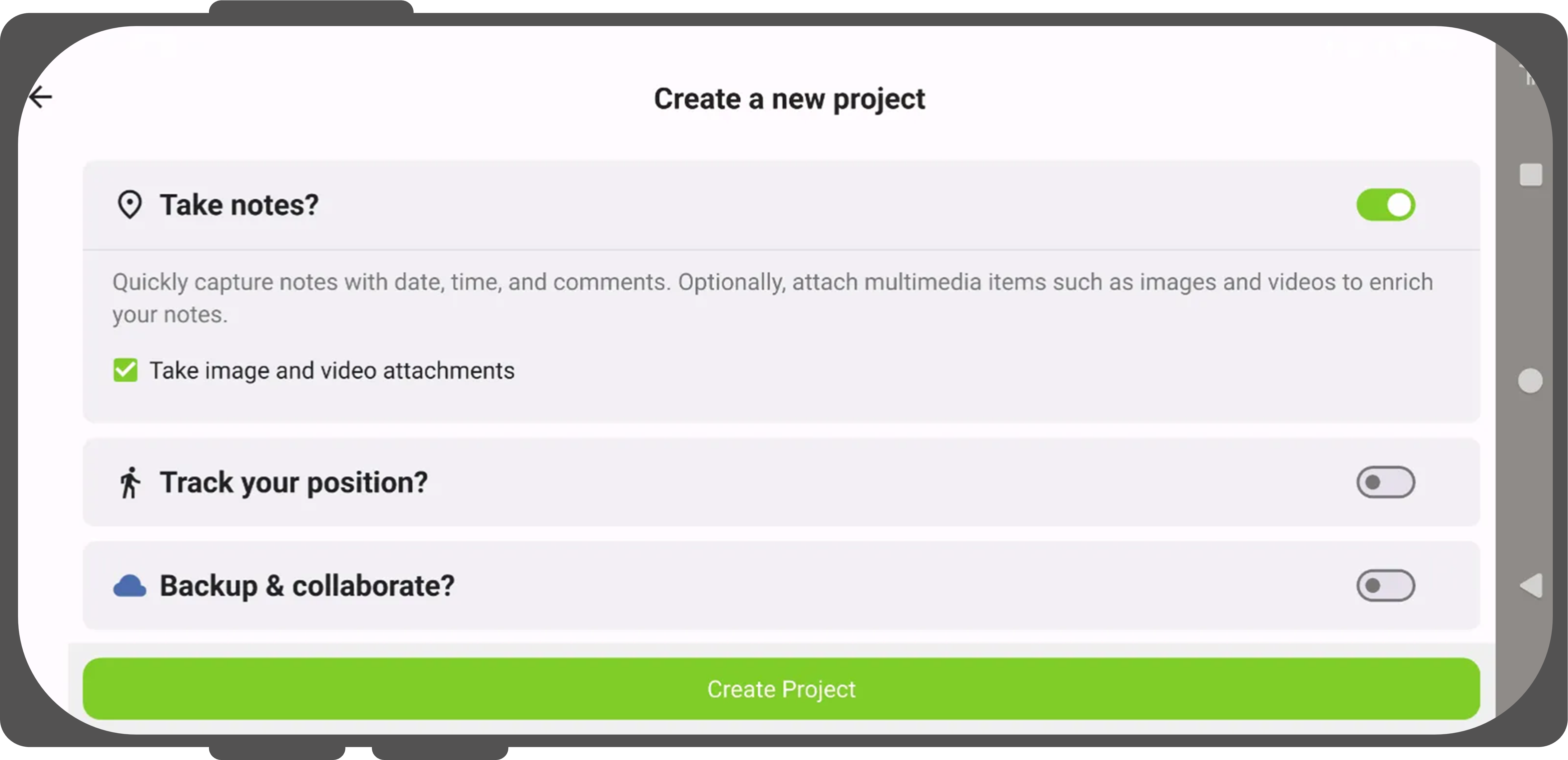

- Enable Add photo attachment to capture attachments for your notes layer.
- Enable tracking to record location tracks (and optionally enable Start tracking on project launch).
- Enable Upload to QFieldCloud to convert the map into a cloud project upon creation.
- Log in with your QFieldCloud credentials if prompted to synchronize the project immediately to the cloud.

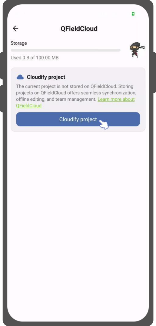

If you copy a project from your desktop or receive project access through a QR code, QField opens it as a local project. You can convert local projects into QFieldCloud projects at any time.
Workflow
- Open your local project in QField.
- Open the Side Dashboard and tap the cloud icon.
- Log in with your QFieldCloud account credentials if you are not signed in.
- Tap Cloudify project.
- QField automatically packages your local layers, creates the project on QFieldCloud under your account or organization, and uploads all initial project files and datasets.
