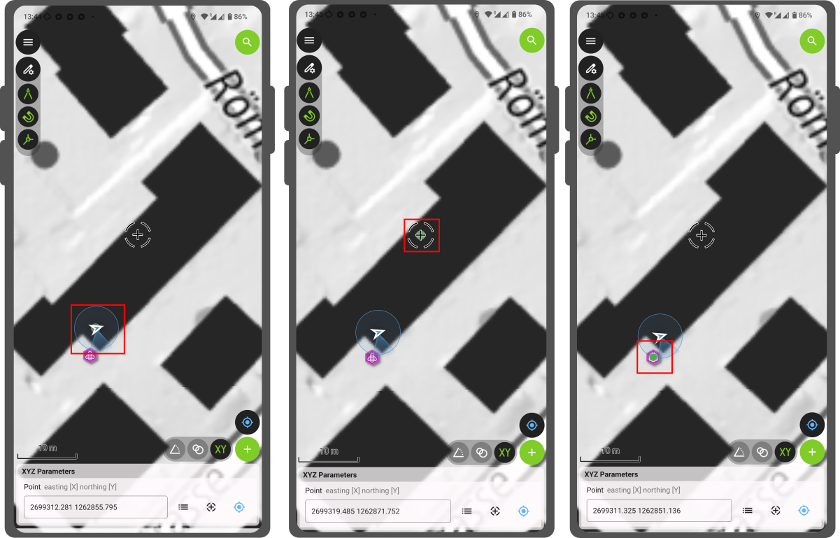

Point by XY[Z]
Construct points using exact coordinate values. This is useful when entering precise coordinates received from external surveys or spatial data sources.
Flux
  1. Tap the XY icon on the COGO tools overlay.
  2. Select a coordinate source method:
    • Select a feature location using the feature picker button.
    • Use the map crosshair location.
    • Use your current GNSS location (positioning must be active). (Note: If the target layer supports 3D geometries, enter an Elevation value).
  3. Confirm coordinate values. A green preview vertex displays on the map canvas.
  4. Tap the green plus button (+) to save the new feature.

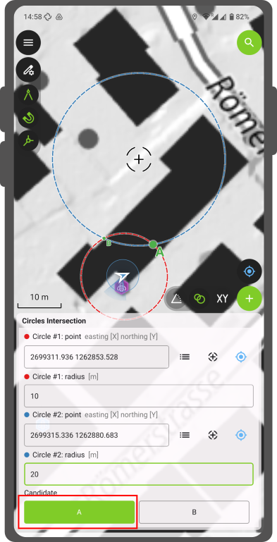

Point at Intersection of Two Circles
Construct points at the intersection of two circle radii drawn from reference origin points. This is useful when digitizing unreachable features (such as measuring offsets from two known survey points).
Flux
  1. Tap the two circles icon on the COGO tools overlay.
  2. Set origin center points and radii for two circles using feature picker, crosshair, or GNSS location options.
  3. Select preferred intersection point A or B displayed on the map canvas.
  4. Tap the green plus button (+) to save the feature at the selected intersection point.

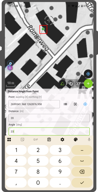

Point by Distance/Angle [to Another Point]
Construct points using distance offsets and bearing angles from an origin point. This is useful for utility and cadastral surveys measuring precise property boundaries or pipeline offsets.
Flux
  1. Tap the angle icon on the COGO tools overlay.
  2. Set an origin point using feature picker, crosshair, or GNSS location options.
  3. Enter distance and bearing relative to North. (Note: If the target layer supports 3D geometries, enter an Elevation offset value).
  4. Inspect the virtual dashed line and green preview point connecting the origin to the target location.
  5. Tap the green plus button (+) to save the feature.
